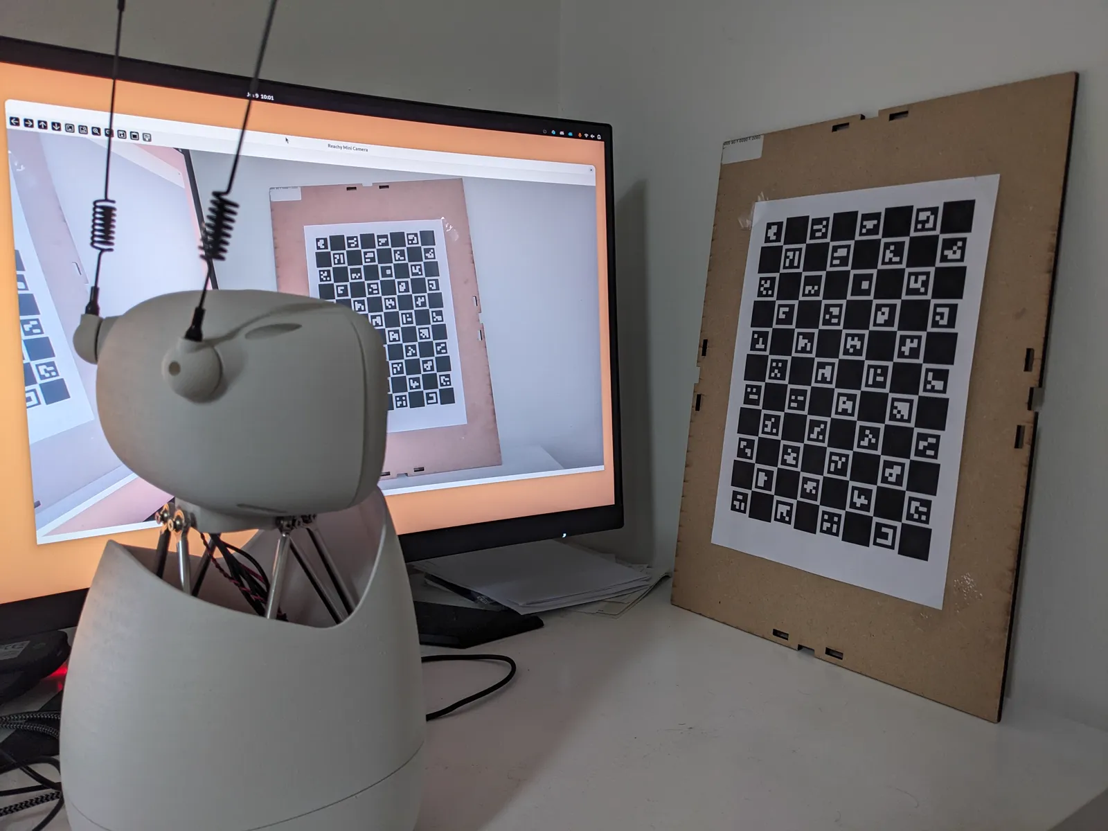

The camera is calibrated with multical, so its parameters are available for any computer vision task (see the look_at example).

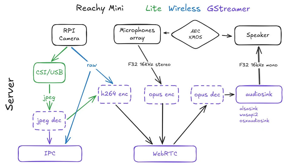

Server side (Reachy Mini)
The goal on the server side is to make the camera and microphone reachable from both local and remote clients.
"Local" covers two cases. On the Lite, the SDK reads frames from the USB-connected camera on the host computer. On the Wireless, an app can run directly on the embedded Raspberry Pi compute module. The Wireless is also meant to be used remotely (a user might want to grab frames with the SDK and process them on a separate computer), and remote access is required for web apps (see Remote apps below). So the Lite needs to expose its audio/video stream too.
To cover all of this, we built a single GStreamer pipeline around two outputs. The camera stream is forwarded both to a webrtcsink element (for remote clients) and to a local IPC endpoint: unixfdsink on Linux and macOS, win32ipcvideosink on Windows. The point of splitting the stream this way is to avoid locking the camera to a single consumer: a remote viewer and a local app can read it at the same time.
IPC
IPC (inter-process communication) is just a fast, local channel between two processes on the same machine. Here it lets an on-device app receive raw camera frames straight from the daemon, with no encoding or decoding in between.
Audio is simpler, because the sound card can be opened by several clients at once. On the server side, we only need to route the audio to the WebRTC element. If a local client wants to open the audio device, it can do so directly through GStreamer, with no need for IPC.
Server-side media pipeline on Reachy Mini
Server side: a single GStreamer pipeline feeds both a local IPC endpoint and a WebRTC sink, so a local app and a remote viewer can read the camera at the same time.
For those familiar with GStreamer pipelines, this translates into:
gst-launch-1.0 webrtcsink run-signalling-server=true meta="meta,name=reachymini" name=ws libcamerasrc ! capsfilter caps=video/x-raw,width=1280,height=720,framerate=60/1,format=YUY2,colorimetry=bt709,interlace-mode=progressive ! tee name=t t. ! queue !  v4l2h264enc extra-controls="controls,repeat_sequence_header=1" ! 'video/x-h264,level=(string)4' ! ws. t. ! queue ! videoconvert ! video/x-raw,format=BGR !  unixfdsink socket-path=/tmp/reachymini_camera_socket alsasrc device=reachymini_audio_src provide-clock=false ! ws.
This is for the Reachy Mini Wireless (Raspberry Pi). The pipeline is slightly adapted for other platforms.

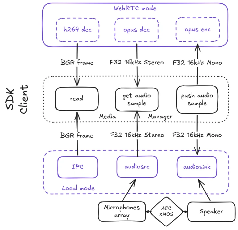

Client side (your computer)
The client side mirrors the server. There are two cases: a local client, which reads frames from the local IPC endpoint, and a remote client, which receives them over WebRTC. The SDK auto-detects which one applies: if the daemon's local endpoint is reachable, it uses IPC; otherwise it falls back to WebRTC. Either way, your code calls the same API. Many examples can be found in the documentation such as the look at or sound playback.
Client-side media consumption on your computer
Client side: the SDK reads frames from the local IPC endpoint when the robot is reachable locally, and falls back to WebRTC otherwise. Your code calls the same API in both cases.
So far we've covered how the SDK reads the streams. But the WebRTC path opens up more than that: it lets apps run far from the robot, in a browser or on a remote server. Let's see what that enables.
The GStreamer pipeline to consume the streams locally is:
gst-launch-1.0 unixfdsrc socket-path=/tmp/reachymini_camera_socket ! videoconvert ! fakesink alsasrc device=reachymini_audio_src ! queue ! audioconvert ! audioresample ! fakesink
And for a remote client:
gst-launch-1.0 webrtcsrc signaller::uri="ws://<ip_robot>:8443" connect-to-first-producer=true name=src src. ! videoconvert ! autovideosink src. ! autoaudiosink
In our SDK, the sinks are appsink elements that expose the frames and audio samples to your code, but these pipelines are still handy for debugging!

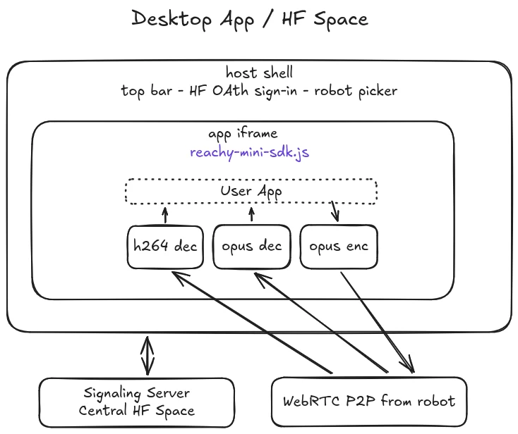

JavaScript apps
The reachy-mini-sdk package lets you connect TypeScript/JavaScript apps to Reachy Mini. The WebRTC example showcases the video stream, audio, and robot control.
Combined with Transformers.js, you can bring state-of-the-art models to your robot with very little effort. Thanks to WebGPU, advanced AI models can run directly in the browser, and because the connection stays peer-to-peer, the data never leaves your local network. For example, the bedtime story generator relies on a local LLM (Gemma 3) and local TTS (Kokoro) to write and tell stories.
A JavaScript app running entirely in the browser, driving the robot and consuming its streams over WebRTC.
Under the hood, our reachy-mini-sdk.js provides the WebRTC plumbing that consumes the audio/video stream from the robot. It also offers a host module that handles the connection to Hugging Face Spaces using your account.
Web app connecting to Reachy Mini over WebRTC
A browser app connects to the robot over WebRTC, brokered by the signaling server, then streams media and control peer-to-peer.
