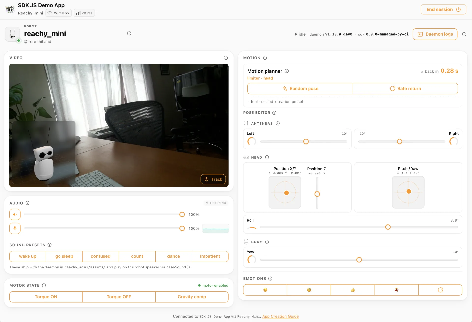

An ordinary app, deliberately
The demo app has no special access. It is a plain Hugging Face Space (tagged reachy_mini_js_app) that mounts the host shell and receives a connected ReachyMini instance - exactly like any community app. Everything below is available to anyone's Space on day one.
The SDK JS Demo App connected to a robot: live camera feed, audio controls, motion planner and pose editor
The SDK JS Demo App, connected to a live robot: every SDK command surfaced as a control - video, audio, motion planner, pose editor, emotions and motor state.
Every panel in that screenshot maps onto one leg of the connection.
The video leg is the live feed in the corner: one attachVideo(videoEl) call and the robot's camera plays in a <video> element, with the robot's microphone pulled along on the same track. This is also the local OR internet claim from earlier, made concrete: the same Space, the same autoConnect(), shows a robot on your desk over the LAN or one in another country over a relayed link - and the app never learns which one it got.
The audio leg is the sound panel: built-in presets play through playSound(), your own files ship over with uploadAudio(), and volume and mute controls cover both directions of the stream.
The data channel is everything else on the page, in both directions. The pose editor streams setHeadRpyDeg() targets as you drag the sliders, the emotion buttons fire playMove(), the motor panel flips torque and control modes - and the same channel talks back: the daemon logs pane (subscribeLogs()) and the live pose readout (subscribePose()) are the robot streaming to the app over the very link that drives it.
